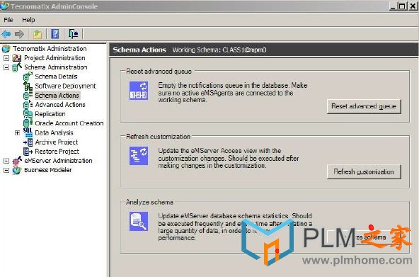

在admin console中的步骤是:
1. RUN "REFRESH SCHEMA" UNDER SOFTWARE DEPLOYMENT
2. RUN "RESET ADVANCE QUEUE" UNDER SCHEMA ACTIONS
3. RUN "ANALYZE SCHEMA" UNDER SCHEMA ACTIONS
