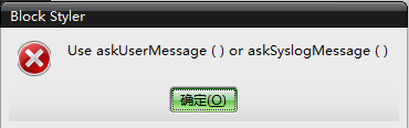

花在人间 发表于 2014-5-7 23:39:41
花在人间 板凳
2014-5-7 23:39:41
PLM之家NX 发表于 2014-5-7 19:37
: ]9 \, q6 A5 o% |  M& Y怎么调试的 啥错误看看
. t/ V( a1 T6 k
捕获111.PNG # ?! {: z1 x0 ?3 D, ~
运行出现以上错误信息,这是catch里面执行的吧( I- M3 s" A) }3 v9 T( M" w

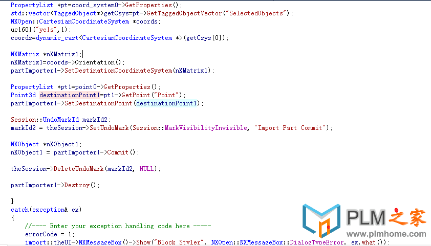

主要代码如下:) f8 p( x2 G) z6 y8 r+ U
PropertyList *pt=coord_system0->GetProperties();
  s2 Z1 C: S3 Z& v+ q5 J6 C) @$ Q        std::vector<TaggedObject*>getCsys=pt->GetTaggedObjectVector("SelectedObjects");; L# R. ]5 `/ ^' A. v
        NXOpen::CartesianCoordinateSystem *coords;9 M3 S; s# x( P- [/ A
        uc1601("ye1s",1);
) s; ~6 i# g4 _( v1 S) D8 f        coords=dynamic_cast<CartesianCoordinateSystem *>(getCsys[0]);0 S- b) `3 ?  j
) P  z  V" M! C! H* a0 T$ o        NXMatrix *nXMatrix1;# B  ^, }' P7 f9 C
        nXMatrix1=coords->Orientation();
- b6 l6 D0 p! V  V        partImporter1->SetDestinationCoordinateSystem(nXMatrix1);, {# A2 Q) i: O  n. p; ]% A& v/ Z8 P
, p7 t; G0 q4 b6 f; T        PropertyList *pt1=point0->GetProperties();: K/ G2 O, k( d# R0 ~, \9 q) }
    Point3d destinationPoint1=pt1->GetPoint("oint");2 h4 q' N! L$ }0 r; m5 w* ^
    partImporter1->SetDestinationPoint(destinationPoint1);5 s4 b% y, h( u  |" B4 @
3 f$ W, v1 o- G. Q( G7 Z! y    Session::UndoMarkId markId2;# Z' o  U  m1 D
    markId2 = theSession->SetUndoMark(Session::MarkVisibilityInvisible, "Import Part Commit");
0 M$ A3 ]/ r. r' v
# q7 p7 T* V3 o, d9 S0 p& \! S( l    NXObject *nXObject1;! @5 v" T3 W( N2 R/ |; s( W
    nXObject1 = partImporter1->Commit();
- g- e- J! n$ M+ ^  C5 m+ J; Y6 K  H& |! A/ ]' s
    theSession->DeleteUndoMark(markId2, NULL);3 M! o, S2 O% }3 L1 [  ^
$ s- C7 Q. |1 H' G/ [. a7 R- O    partImporter1->Destroy();- U: A; w( r3 ~6 c3 o( T
$ ]0 @; Z. i% j: Y" K    }
6 I! x* i$ a& G6 L" X    catch(exception& ex)
' k- _9 y& E) {& u& I  q    {
( x+ a+ h8 t5 z$ K. n# L2 _2 ]& h        //---- Enter your exception handling code here -----* H6 b5 P- i# B9 r/ \$ R
        errorCode = 1;( C) ~$ I. r, H1 \
        import::theUI->NXMessageBox()->Show("Block Styler", NXOpen::NXMessageBox:ialogTypeError, ex.what());
( `2 H6 U6 O5 q9 P) }    }3 Y9 }! g9 J* |6 M" [3 C7 q
    return errorCode;9 A  ~. K4 f) K, b2 P
3 P9 U# f: l  H+ j; {
$ O% D- p- U1 ^  M# p9 B& j  T. n1 \+ k  z/ o. ^0 t9 a. a
