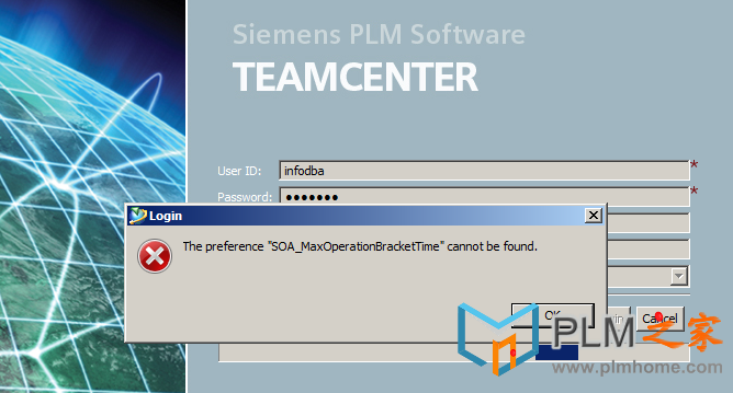

43. 登录Teamcenter报错“'SOA_MaxOperationBracketTime'”
6 `* Y& |, [6 X" G  |- V5 |2 K* g- J7 W; @5 j: q# t/ t9 Z
0 ?6 X& ]8 ]. c( ?. L
, \3 u# d  d. ]- F( d% z2 k/ i9 S$ }( v+ |' D
  T$ n# J* f( iSolution: O! M0 G' `3 M
' V, G& G* a) t2 B1 s; J" N* w( \- k主要是检查数据库是否OK,通过sql进行连接数据库,看是否正常。也有可能是数据库密码过期,看下面的处理

Solution( w. P) B" t% m
, L% Q8 M* `; G8 z7 L  u4 g: PThis is due to the Oracle Password having expired and needs to be reset.3 S) T7 k1 N# B- D
5 D/ o' i5 V2 k% y, ^Perform the following in a OS CMD window making the necessary changes for your: ~4 V+ n( |, z
environment and directory structure.6 h/ V8 F9 a$ ~
/ i: C5 t9 G9 s
1 |. r, Q8 E* e; E; f! s/ u! T  Eset oracle_home=C:\Oracle\product\11.2.0\dbhome_12 R) S( c2 A& r4 {1 f
1 E' s* E+ O, a- f  F0 I2 A
set oracle_sid=tc
1 C1 k* Z$ U* K2 w7 K/ j4 I9 @3 }5 d8 n8 D2 Q' E# Z
%oracle_home%\bin\sqlplus /nolog+ V2 r# ^$ m% a* W7 Y' {1 x' W! Z# Z
- C2 N# W9 f! nconnect / as sysdba
3 E2 M% H- }% K' [. T! y6 f' R4 z3 v8 P$ V8 o1 s6 I+ f, p/ x6 v4 H
alter user infodba identified by infodba;+ p5 w; M$ {2 K0 h9 t5 `- V% h
1 {2 P9 T/ H, N' N/ ]
select expiry_date from dba_users where username='INFODBA';
$ H' M: V( z; v: ^* i3 T* I. Z" H& h, E
select profile from dba_users where username='INFODBA';
1 n2 J9 W: A' C" T8 T; P9 T! g
3 d2 |7 c: t, y% D2 ~alter profile default limit password_life_time unlimited;/ m  {2 i7 J3 w0 Y1 d
! K6 t$ p' w8 L
select expiry_date from dba_users where username='INFODBA';8 q7 \& s) w! q+ U
8 T, G) T0 F! A- l# ?5 n
