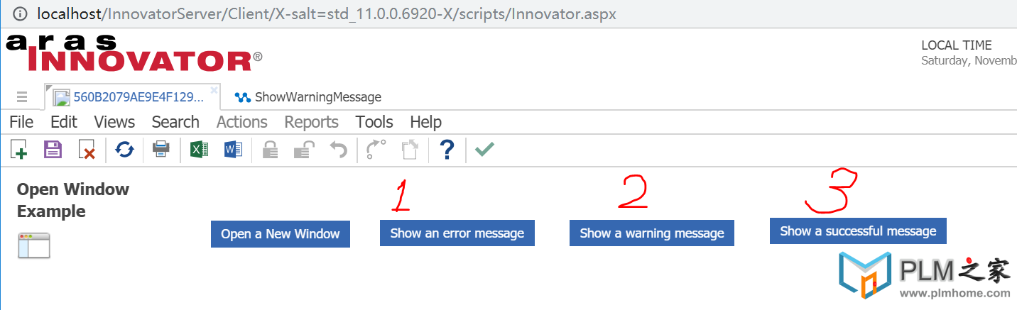

1、ItemType-Form中增加三个按钮。, {+ Y  @- x+ g+ h
1 p% N+ C# k1 E( W
! Z6 p6 V8 i$ r% \
2、对应Method代码为:
aras.AlertError("Error Happened");

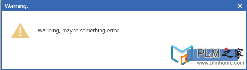

aras.AlertWarning("Warining, maybe something error");

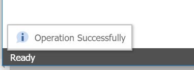

aras.AlertSuccess("Operation Successfully");
3、弹出的窗口效果如下:(其中Success消息框在左下角状态栏处弹出并会自动消失)
