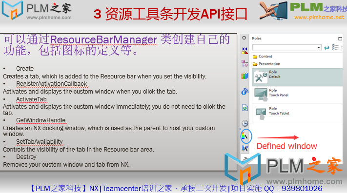

【PLM之家NX10.0新功能视频】3 资源工具条开发API接口
7 ]9 B6 \# d  l2 R1 c! w. U2 }" q5 H' q4 R4 {" f4 {
可以通过ResourceBarManager 类创建自己的功能,包括图标的定义等。
8 m' _! u5 d0 ]; v. p3 T. t
6 N6 v, V6 t9 ~. x6 P4 p, ^) f7 C0 G0 T
Create
% y  H: L3 K# z; o
+ d- T. T" m/ [% B
Createsa tab, which is added to the Resource bar when you set the visibility.
5 `2 `) n" v9 ]" g1 q
RegisterActivationCallback
% \" O7 {$ A& f0 u
( Z7 r2 i& w# Q8 B
Activatesand displays the custom window when you click the tab.
* O; c+ ]' r, h
ActivateTab
# s- R% o6 c& L% N' ]& O7 e4 B; U  e7 _
Activatesand displays the custom window immediately; you do not need to click the tab.
% h5 |* K2 R" {
GetWindowHandle
1 Q( h0 w" U$ ^% A$ l! H6 O$ L
: E- S+ V- m0 e7 D* h, R
Createsan NX docking window, which is used as the parent to host your custom window.
3 P( v! ^4 a  r! @( I3 B
SetTabAvailability
: f/ `" i. T' ~4 ~
; I8 ?. x; ]7 \  j. q
Controlsthe visibility of the tab in the Resource bar area.
8 [/ O0 L8 s& L- `$ ?1 W/ T
Destroy
" [+ k1 g" p4 `( V$ H+ E# K6 U+ Y
6 _& F) b0 ~& W% N. [* w1 _
Removesyour custom window and tab from NX.
