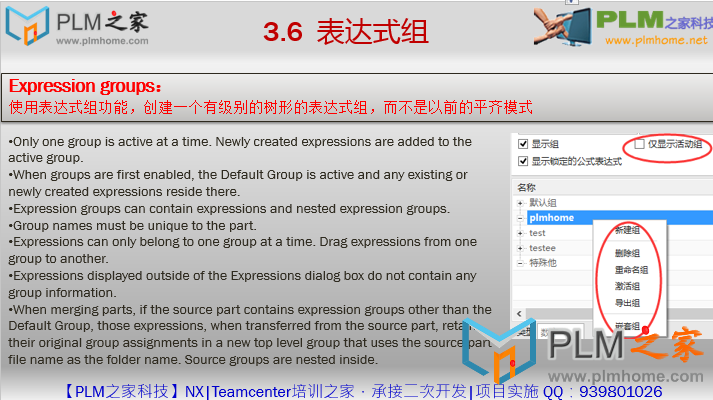

Expression groups:+ ^8 Y1 I3 T0 q3 R/ Q6 T% N5 }& d
使用表达式组功能,创建一个有级别的树形的表达式组,而不是以前的平齐模式
# {  [# ?" T. [; b1 l: xOnly one group is active at a time. Newly created expressions are added to the active group.
, m+ ]% f/ B+ u# u) BWhen groups are first enabled, the Default Group is active and any existing or newly created expressions reside there.
+ t% v) Z2 D' P+ @Expression groups can contain expressions and nested expression groups.: y& f4 d- E' s
Group names must be unique to the part./ [' L. T' I: b1 B6 F' M( J0 b
Expressions can only belong to one group at a time. Drag expressions from one group to another.
1 |; K% H3 F/ hExpressions displayed outside of the Expressions dialog box do not contain any group information. ) V+ g; `  Y! \& F& Y
When merging parts, if the source part contains expression groups other than the Default Group, those expressions, when transferred from the source part, retain their original group assignments in a new top level group that uses the source part file name as the folder name. Source groups are nested inside. ) y" ]# \1 y( r8 i* i5 i, e
