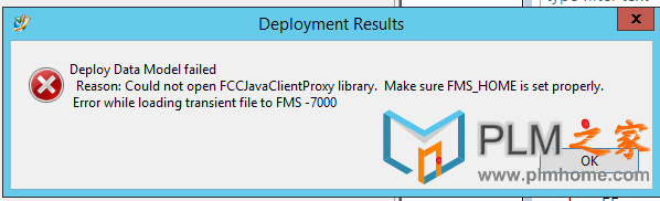

Could not open FCCJavaClientProxy library. Make sure the FMS_HOME isset properly. Error while loading transient file to FMS -7000"

. T" P6 \6 u: z1 O# N1 S2 g- l errror2.PNG ' [% V; _8 L" |. b1 J
8 a. X3 Y0 k" N0 f6 l% m4 o解决方法就是要安装以下2层的BMIDE,standalone的不行!- D5 g- t. u; o
* p: |* v5 k" |7 h
2 h% k% Q# B' ^% GThis error is seen when you have a standalone version of BMIDE. Due to which itdont get connected to your 2 Tier or 4 tier connections (or FMS) reporting anerror.To Fix:- Check FMS_HOME is set to %TC_ROOT%\tccs.- Check fccstat -status    It should appear online (started), If not run fccstat -start.- Run Tem.bat (Environment Manager) and install   2 tier BMIDE client (For 2 Tier setup)  4 tier BMIDE client (For 4 Tier setup)Now retry Deployment, it should work just fine.
