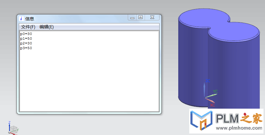

[交作业] 创建两个圆柱体,求和,涂色,输出表达式并倒圆角。
2015-7-24 20:03:48 3263 1
秋爱 发表于 2015-7-23 17:23:00 |阅读模式
秋爱 楼主
2015-7-23 17:23:00

    /* TODO: Add your application code here */9 C! x, n1 L) |2 w8 M) \
! M- e, y$ w! t+ d, A0 T9 X
3 M$ K' t# J4 ~2 a( J4 [" H+ T
        UF_PART_new("e:\\NXopen\\cc.prt",1,&part_tag);, |$ s1 W, J  ?) Y5 Z4 V
        UF_MODL_create_cyl1(sign,origin,height,diam,direction,&cyltag);
( X. }* Y0 \+ N/ r/ x        UF_MODL_create_cyl1(sign1,origin1,height1,diam1,direction1,&cyltag1);//与第一个圆柱求和
6 f' o# `. a/ H$ n: `        UF_MODL_ask_feat_body(cyltag,&cyl_body_tag1);
  w: z" J: G/ V: o; z3 @        UF_OBJ_set_color(cyl_body_tag1,128);     //设置颜色
5 n& H' B4 t5 X5 Y  A        UF_MODL_ask_exps_of_part(part_tag,&num,&exps);    //访问部件的所有表达式! \: a/ Q. Q7 R8 l7 x7 L
: o. p3 {6 I( c* _8 @. v& R: D
$ |. I9 |6 k8 ]  W1 |, R1 B) \
        for (i=0;i<num;i++)+ u0 o" A3 t; ]1 e6 W1 p% w9 H
        {4 u8 x9 T5 L% V* H9 D0 a  R
    UF_MODL_ask_exp_tag_string(exps,&string);     //输入表达式标识,返回该表达式串
1 ^$ Y( j7 j! d4 m7 f        UF_UI_open_listing_window();
# l2 l$ L) W/ {7 m" U0 x        UF_UI_write_listing_window(string);
8 S4 T" l' t7 W% O9 o6 E        UF_UI_write_listing_window("\n");
9 h! v4 j0 ~% D1 S& t1 Z' F        }
& d  A9 {% h& R: E    UF_free(exps);) V8 e2 y9 p! Y0 h# @; g/ a  P: N
        UF_free(string);/ D: N+ Z! o, |) c* a. ]2 l7 S3 r
: [! O' f: f- G7 F9 H+ F' g
* H( |8 Z1 s. e8 A
        UF_MODL_create_list(&edge_list);  //创建链表以存放要倒角的边
! ?7 w' y( Z: K, J        UF_MODL_ask_body_edges(cyl_body_tag1,&edge_list);  //获取圆柱体的边
$ ?# `, z; D: E$ A+ C        UF_MODL_create_blend("0.7",edge_list,0,0,0,0.001,&blendtag);  //对圆柱体的所有边进行倒圆角" p5 \2 W3 e" u# \7 O$ n! B% w
        UF_MODL_delete_list(&edge_list);    //删除链表$ Y& V) J2 @9 k& a. v9 X4 f
$ V* r6 e$ \. E: ]
  r! `* Y+ S, X1 c3 o8 @
    /* Terminate the API environment */6 ?' r" a+ K* ?9 n4 ^0 D4 Q9 v
    UF_CALL(UF_terminate());8 \$ u1 P; l8 E8 y  x4 x
