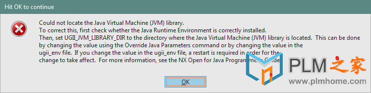

UG NX WAVE relations browser 错误: ERROR: Could not locate theJAVA virtual machine (JVM) library
  m" _5 |" l. D& R

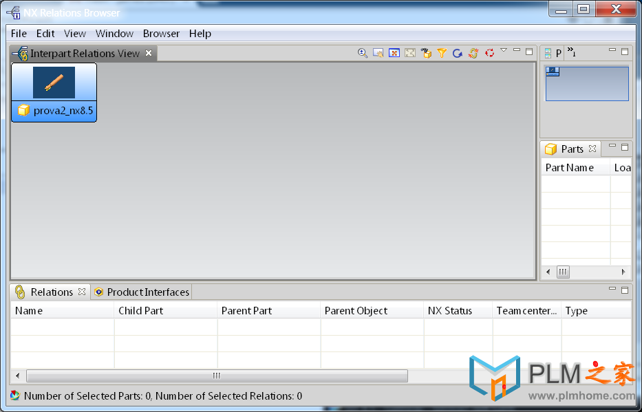

当启动  Assemblies ->WAVE ->Relations Browser 时候报错误
  M7 K# W9 t& u/ H! ^
8 Z# a5 K, R# ^  N; u5 V
解决方法如下:
; s5 g9 d. N, w" G* w" ^
下载 Java 软件安装,并设置环境变量 : UGII_JVM_LIBRARY_DIR = c:\apps\Java\jre7x64\bin\server
' G, R6 P  W3 g7 d+ d$ O) |
