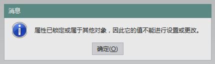

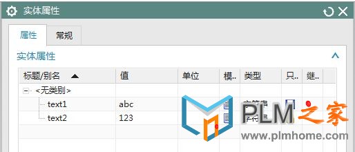

5 I) I* ^. C1 F9 Z% W4 u8 k我在NX9里,建立了一个属性模板,模板内容含两条,其中一条选择保存后锁定,然后在建模环境下创建了一个体,对属性的值进行写入,保存后重新打开,看到属性是如下图1所示的。(这种属性锁定是我所需要的,不是不小心锁定哦~)5 N( m9 ]2 Z  e( z( T2 w% ^

第一个错误出现在UF_ATTR_set_locked这个函数的值,如图2所示。

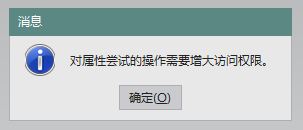

5 {4 E; E: c, s2 a# ~! E2 w$ M第二个错误出现在UF_ATTR_assign这个函数的值,如图3所示。2 ?* ?& ~2 [+ S+ l, @7 U

4 }6 P3 }* q# ^& v- D6 r图1中,text2只读那一栏是锁定的图标
# j7 o6 w. t, zOverview3 k& A/ u: k) U" m, Z+ d
! U; k% x; A! m. h% E6 k1 g& O: l2 N( T
Sets the lock status of an attribute on the object specified. If the attribute does not ( V9 K3 H- U: s" _; Q
exist for the specified attribute type then an error is returned.   g1 S( C! g+ t% t
7 A0 }; G% A3 x3 C: t
Passing an object tag will result in modifying an attribute
4 O6 m$ \5 F- k0 H/ {8 } on that object. Passing in a part tag will result in modifying 0 R7 X3 H  L5 P5 ?2 z. H
a part attribute for that part.
- j! j7 i. ^. f# `. Y2 W
& K3 D3 R4 k3 J* k! h7 A' Q6 I6 z The part in which the object resides must be fully loaded. ' Z( K: `* d& [6 Q  {' ~
. Y) V6 N7 h+ g% C Unlocking a locked attribute requires access via a Customer Default setting ' g  j$ p. \6 j5 ~; {. g8 R6 ]
/ ]$ [9 |" }% b
Discouraged in new applications / p- ]0 i% M: ]

# u* U* Y2 V/ n太棒了,完美解决问题,3Q老大!!
