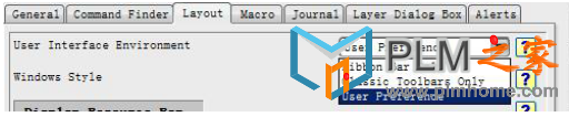

可以通过选择 File-->Preference -->All Preferences-->User Interface-->Layout’页面,进入
User Interface Environment’选项,切换 Ribbon Bar’和‘Classic Toolbars’显示
NX9
NX9
如果看不到 User Interface Environment 选项
检查默认设置 File-->Utilities-->Customer Defaults-->Gateway-->User Interface--> Layout
确认 User Interface Environment 设置允许界面切换.
