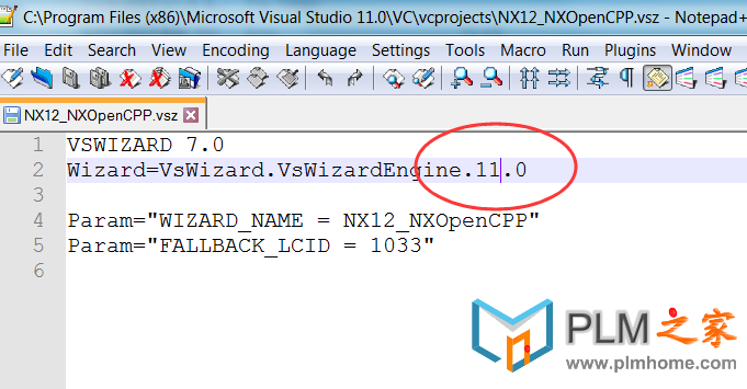

(1)安装完后,点击Open Wizard 告诉你创建项目错误
2 ^  d# K$ ], ~# o, |- s& Z8 ?这种问题就是编译器版本不符合官方的匹配导致的,更改方法很简单
1 P- N: [3 ^7 D7 f% `8 Q- [打开 C:\Program Files (x86)\Microsoft Visual Studio 11.0\VC\vcprojects下的NX12_NXOpenCPP.vsz 将
4 j2 }# g, H- X/ n5 wWizard=VsWizard.VsWizardEngine.14.0 中的14 改成11 也就是对应的VS20129 ?) n3 O' b0 E2 t  M
QQ截图20171031173225.png " d% {5 ~! v0 `
这样创建的对话框就可以出来了!

! p/ O8 q0 o$ ?
8 v" e# ~# D) r; e        //=================================================================
' S& c) e/ n5 m( F% T        //  Debug Configuration% j0 ]* [' e- M, s% A8 ~! d
1 g  l. i/ P1 K) C' i2 s//LRJ - add x64) a9 S1 ~0 g6 S2 F
                var config = proj.Object.Configurations("Debug|x64");
" i) Q) y8 F# N% `0 N( g                config.ConfigurationType = appType;
( i9 {  {8 E' U: s                config.CharacterSet      = charSetUnicode;  [+ g" I0 e5 i
                config.useOfMfc          = useMfcStdWin;) W2 v7 o# @1 S  ]9 `' [5 ?3 \
9 q) w/ G' o# B& Q% m                var CLTool = config.Tools("VCCLCompilerTool");
& w: \. O4 j2 V; A3 x. a                var strDefines = GetPlatformDefine(config);
  t  C  Y5 y9 i3 X                strDefines += "_CRT_SECURE_NO_WARNINGS;_SECURE_SCL=0";% `  o# d4 M0 t5 G0 Z* P2 W- c9 J
                if ( isDllApp )' f2 u. y1 w& y; X7 |1 L3 u
                {9 i3 R3 i9 n: C, H) _& P4 B' W. P- ~
                        strDefines += ";_USRDLL";; ]6 \. o. S* e) ~' z; J  X
* n6 p" @! c0 p                else2 \3 q2 A. K3 N4 s
                {/ c2 X* u- b  t/ n6 p
                        strDefines += ";_CONSOLE";0 H) s1 c9 \: V5 @2 R
) v. x% `* [; G% [# b( F( S$ ~! e% X1 G& p- e1 I, Z- f
                CLTool.PreprocessorDefinitions = strDefines;
2 T0 N7 J; K! J3 g( ?. p) I/ T5 l2 [$ r4 s* x5 M" V
        config.UseOfMFC = useMfcDynamic;
  ^' h8 D0 l! U, u        CLTool.RuntimeLibrary = rtMultiThreadedDLL;$ B3 E4 p4 N  S" v% g. l/ q3 x
8 c% p! B5 x2 P# J                CLTool.TreatWChar_tAsBuiltInType = true;
0 h/ f4 q& e* \3 _( o                CLTool.DebugInformationFormat = debugEnabled;
9 L/ \& }5 v* k! S, R' T* q: ?  b* i        CLTool.AdditionalIncludeDirectories = "D:\\dsplm\\Siemens\\NX12\\ugopen";
. x5 P1 T* p0 D0 ~8 ^$ f: Y9 _
, H8 j8 e9 [/ @0 S1 f/ m        CLTool.RuntimeTypeInfo = 1;
6 t6 M7 k- {6 c        CLTool.UsePrecompiledHeader = pchNone;
$ \- L* D3 d) l                CLTool.AdditionalOptions = "/d1scalableinclude-";7 G5 F# D6 Q" U6 h8 g& e
) N) v* V- n( [# c% {+ W* B0 n//LRJ - change for X64 - add TargetMachine! @, N: z+ Z& G+ |
                var LinkTool = config.Tools("VCLinkerTool");
! [$ a$ T) h& P/ ?( Q( o7 R  J        LinkTool.TargetMachine = machineAMD64;
$ r, A5 ?8 ]. w" {& G4 u* q                LinkTool.LinkIncremental = linkIncrementalYes;
& ?. [/ x4 f8 |% _) H                LinkTool.GenerateDebugInformation = true;
3 e  M+ U3 I! h* h$ _$ p3 [                LinkTool.OutputFile = "$(OutDir)/" + strProjectName + appExtension;
3 [  H9 k, m3 U/ K& O% G                if ( isDllApp )2 U% w6 e. A% z( e8 W! D/ W( z
            LinkTool.ImportLibrary = "$(OutDir)/" + strProjectName + ".lib";8 D) q9 |7 E  }# I7 a4 H' }& }
        LinkTool.AdditionalLibraryDirectories = "D:\\dsplm\\Siemens\\NX12\\ugopen";
9 ?. ?' V$ _7 R5 |( l' ]- I# b        LinkTool.AdditionalDependencies       = linkLibs;
2 R$ V5 {: ~  b' u9 T6 ?        LinkTool.SubSystem                    = subSystemConsole;# \5 r1 V% E" D6 |0 l+ X* L2 ]
//LRJ - add following line for X64 definition
3 r( g% t! T" }0 B8 L; Z% f        dte.ExecuteCommand("Build.SolutionPlatforms", "x64");/ H: @0 p8 O" M
8 a$ J9 h7 [+ ~
        //=================================================================5 e$ ]( {+ ?' ^4 y6 m: ^- z
        //  Release Configuration( N1 u9 n+ I2 ^' f
        //=================================================================$ U" u. [4 [7 Y% v9 b
//LRJ - add X64 definition to configuration line
% P1 n3 f! e4 G9 I) e; M                config = proj.Object.Configurations("Release|x64");
- f$ d+ e4 Q9 E& G                config.ConfigurationType = appType;- p# ^0 D& y! V# i, E8 o6 I/ U
- i9 D' r& [& {. _+ m$ j8 g* ^' n                config.useOfMfc          = useMfcStdWin;, S; C9 @( u, s9 g
3 [+ G; q3 I0 o* p8 F
' ^- A( V( d! K6 ?                strDefines = GetPlatformDefine(config);
% [" m- L$ q1 Z; e                strDefines += "_CRT_SECURE_NO_WARNINGS;_SECURE_SCL=0";
1 B) h. s0 J! \2 a  ~* J; G                if ( isDllApp )' A# @! W* F: C0 K
                {% n7 ~6 I/ `+ H  u
, d9 N5 G; p. e1 x5 ?  {1 V                }; i, f( g- |) p3 ^2 O- X+ H
                else
' S1 Y! i! }+ l                {
+ r" ]: M' `! M                        strDefines += ";_CONSOLE";; O) D' G8 M: g. f5 V. N; h
                }5 R) Q2 c8 j! P
- }1 Q' M' @/ @* z7 e                CLTool.PreprocessorDefinitions = strDefines;5 Q4 P8 t# ~* n  M# X+ ^6 d9 X
0 w: M6 x' q  J
        config.UseOfMFC = useMfcDynamic;" z, `$ }! v+ h
        CLTool.RuntimeLibrary = rtMultiThreadedDLL;4 Y9 A9 r9 Y. |: A: Q# A% p
2 V4 q: }6 h  G2 e
                CLTool.InlineFunctionExpansion = expandOnlyInline;
/ k  a- C# K3 X: `, c; V( {4 a; y                CLTool.TreatWChar_tAsBuiltInType = true;0 [8 y, y8 [, x$ P3 o
, G5 i1 F. H7 e! Q* ~0 S9 j( l6 w6 e3 v7 v* L2 ~3 R
        CLTool.AdditionalIncludeDirectories += ";D:\\dsplm\\Siemens\\NX12\\ugopen";
. ?/ C' ?2 A3 R$ P+ ^' H; \
% I: G& N. @$ F        CLTool.RuntimeTypeInfo = 1;
/ X. u5 M* f) i9 u9 A) H) M1 D8 g: d        CLTool.UsePrecompiledHeader = pchNone;- }3 W4 m2 D8 \! t. J5 n
                //CLTool.AdditionalOptions = "/d1scalableinclude-";
8 J; s! _" w  `5 [* q6 G" |9 U- {) [1 j2 H8 b0 I1 r+ T( m
) _6 j/ x: I! _: S1 \6 X0 b. Z//LRJ - add following line for X64 definition/ r. K7 j. O/ ]( b
        LinkTool.TargetMachine = machineAMD64;; ?7 M# L( E, |' f2 `5 s' h
4 j0 n& G6 A+ }, K% c8 L& k                if ( isDllApp )
7 V; K- E3 ]! l! `# ^8 |            LinkTool.ImportLibrary = "$(OutDir)/" + strProjectName + ".lib";; a, w, O. a2 p2 m/ k. i7 l
                LinkTool.GenerateDebugInformation = true;' k! G, r% _% G" K2 f+ `4 f; q8 A( T$ l
                LinkTool.LinkIncremental = linkIncrementalNo;
  Y9 l# i- M  m% D" A/ A" R0 h        LinkTool.AdditionalLibraryDirectories += ";D:\\dsplm\\Siemens\\NX12\\ugopen";
" J4 k$ o7 k/ Q& k8 l) T# E        LinkTool.AdditionalDependencies       = linkLibs;: W2 @' {# d) Y) v7 A
        LinkTool.SubSystem                    = subSystemConsole;  D, N: f8 @6 }1 V/ l4 w; ?
//LRJ - add following line for X64 definition! Q. n+ w( \+ T  g* ]
        dte.ExecuteCommand("Build.SolutionPlatforms", "x64");) n% u' z  q8 b& r* @1 k0 h  o3 @  j
8 X! t+ ~  b4 |$ A; `% {6 B        catch(e)
8 ~  I' g3 U) K        {
5 d: b: Q0 E3 p- \                throw e;1 E& d3 @/ }+ }+ N! W+ o- F
$ E; ?& {5 [+ c- X& P( U! l4 |: }}
/ s, w0 i. `0 T9 R, P) `
' H! r9 Z2 Z0 X
3 U/ h" y4 ?) \. V' k' a, D% Y" c) S% H4 w

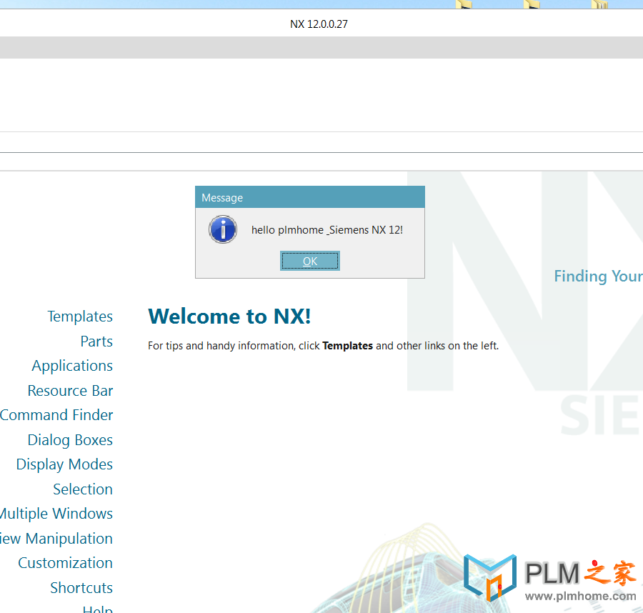

82170
 楼主| 发表于 2017-10-31 18:00:45 | 显示全部楼层
结果如下:6 u4 R8 W3 I3 N
: l6 j1 H4 K" ^# @3 S" n" N6 b( X  B QQ截图20171031180019.png ' a$ d; P1 z$ U
