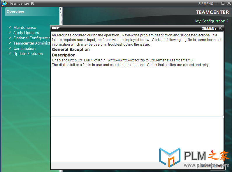

36. 升级Teamcenter出错:Unable to unzip - y7 A2 y, y0 Z% u0 x+ r5 c- z' @
4 u6 N. ~6 |& \+ A9 v2 V& b这个错误很明显,空间不够。5 A/ j7 u# C2 h. N4 B0 I+ y
% j) F. B2 z0 V! S  d/ m. r  @
. R7 d# Y; Y" i% H0 M9 O
+ Y0 Q$ c* a9 c0 D7 {7 X9 CUnable to unzip C:\TEMP\TC10.1.1_wntx64\wntx64\tc\fcc.zip to C:\Siemens\Teamcenter10
5 k, y% h. b  l$ w7 B! O5 m$ l( qThe disk is full or a file is in use and could not be replaced.  Check that all files are closed and retry.% M  p, n3 d8 ^/ I7 _2 _- g

发表于 2016-6-19 10:38:21 | 显示全部楼层
实际上我遇到过的并不是空间问题,有可能是目录结构太深,我一般都是手动解压这个fsc
