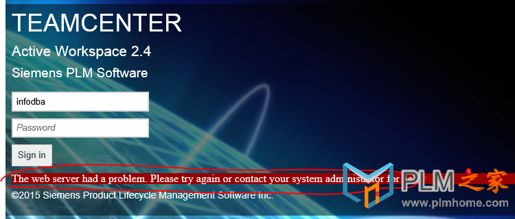

: s* l) b% a  V' ~Error when going to active workspace login screen (not actually trying to login).
The
web
server
had
a
problem
. M4 |* U- r% G) z6 \' j( W
" `$ E$ x* ?. W5 k! z1) Check the TC_ROOT\aws2\stage\tem.properties and make sure the following 2variables have the correct address listed: # d6 E! O4 Z6 a7 v1 q# A& n
ProxyServlet.redirectURL= + |/ m/ L* }, D2 E
FmsProxyServlet.bootstrapFSCURLs=
3 u9 p& }5 c( m" Q6 O; H
' A1 p1 |- y0 ~/ v" Z& q1 \
& k+ z& F: S7 Z 2) If not, correct the address and re-run the gwtcompile.cmd to rebuild the warfile with the correct value.
# V% _2 ]5 S3 _
& i3 h4 m; p9 ^0 o+ H# B2 E1 S$ V7 }2 D
3) Re-deploy the war file.
