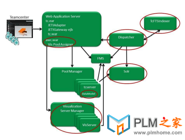

An Active Workspace Client deployment takes advantage of existing Teamcenter
; f/ |; c# z4 H$ D5 V7 b$ Linfrastructure, adding several additional components.  The following are the. ]+ f& }4 z4 Z8 t* B4 Z9 B
components of an Active Workspace Client deployment:
/ Y; C6 y6 i6 n6 X/ v•    Teamcenter Corporate Server components and 4-tier deployment architecture.
' x6 B0 x0 K1 {  n; K0 {•    Corporate Server data model additions:  A new corporate server
. c; b  [) D1 w7 qextension/template./ r% K# c  j- B5 J, P- I
•    War fil e   deployment: A new web application that makes up the client application.0 @; F; s. K  H$ k# ~5 [
•    DispaTCher: An asynchronous executor and load balancer of scheduled jobs.
1 X# f* ?" @7 W! Z, V•    Visualization Server Manager: A rendering server for 3D visualization.
' k/ K- V5 k' g$ l•    TcFTSIndexer client: A 4-tier client application used to update the search engine.
1 Y. e7 Z) H; f, V; R8 V0 S1 t•    Solr database: A full-text search engine.2 D/ y: v7 J5 A0 s
The main components (boxes in the image below) can be deployed on a single4 I: t1 J5 Z2 m3 j' ]
machine or on different machines depending on individual needs.  The circled
; j& S6 k+ Z. P6 Fcomponents are new for the Active Workspace Client deployment.! z3 O+ p# k7 b5 n6 @+ L2 b! j
Teamcenter active workspace infrastructure
